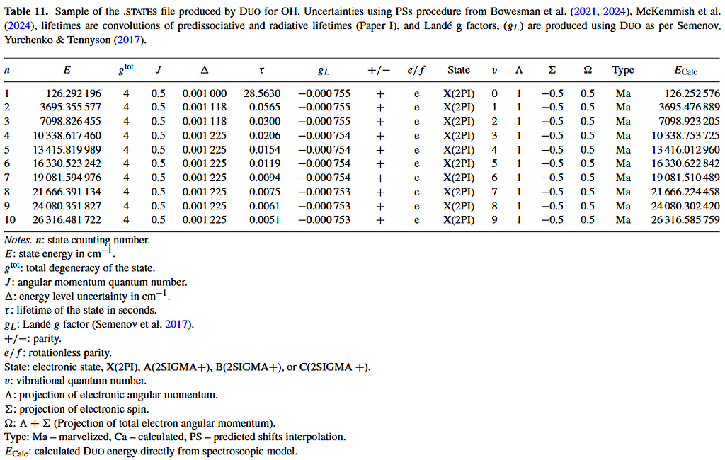

Sample of the OH .states file format showing electronic state information and quantum numbers.
To kick off the first milestone, I’m using the .states file from ExoMol for OH molecules, which has all the electronic state info and quantum numbers. RADIS already has a read_states() function in exomolapi.py that can parse this format, but right now it only extracts:
  • i: State counting number
  • E: State energy
  • g: State degeneracy
  • J: Total angular momentum
I’ll modify this to additionally extract the electronic-specific parameters:
  • State: Electronic state label (e.g., X(²Π))
  • Λ: Electronic angular momentum quantum number
  • Σ: Spin angular momentum quantum number
  • Ω: Total electronic angular momentum quantum number
  • Type: State type (e.g., Ma for main)
This will be the foundation for getting electronic transitions working in RADIS.

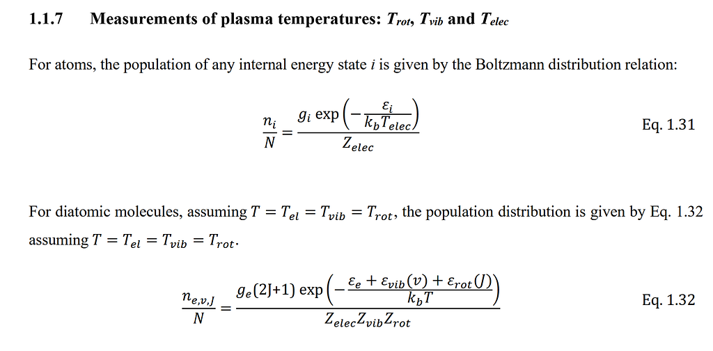

For the population calculations, I’ll be working with the existing partfunc.py file. I'm planning to create a new ElectronicPartitionFunction class and implement the Boltzmann distribution for electronic states. Nicolas referenced a formula from his thesis (Chapter 1, Section 1.1) that’s relevant to what I’m implementing.
All of this will eventually get integrated into SpectrumFactory to compute electronic spectra in SpectrumFactory.non_eq_spectrum(). I'll be adding an electronic temperature (Telec) parameter and thinking about using the overpopulation parameter for manually adjusting electronic band intensities.
