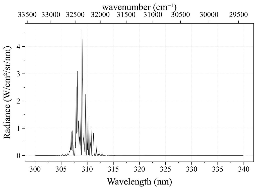

Next, I compared the generated spectrum with the reference one Nicolas had shared. It matched quite well except my plot showed too much population in the high vibrational states.
Reference vs Plotted Spectrum
The root cause turned out to be the default fallback values for vibrational quantum number (v) and degeneracy when parsing failed. That’s now fixed; the correct vibrational levels are being parsed properly.
At this point, the code returns NaN for transitions with v>10, so the output is restricted to those with v≤10. In this case, 714 transitions are excluded, and the resulting spectrum closely matches the reference.
Spectrum after Filtering
What’s causing the NaNs?
The partition function was only being calculated up to vibrational level 10, while the line database includes levels like v = 11–13. When the code attempts to fetch partition function values for these higher levels, it receives None, which becomes NaN in the DataFrame. This breaks the nu (upper state population) calculation, which relies on a valid Qrotu.
